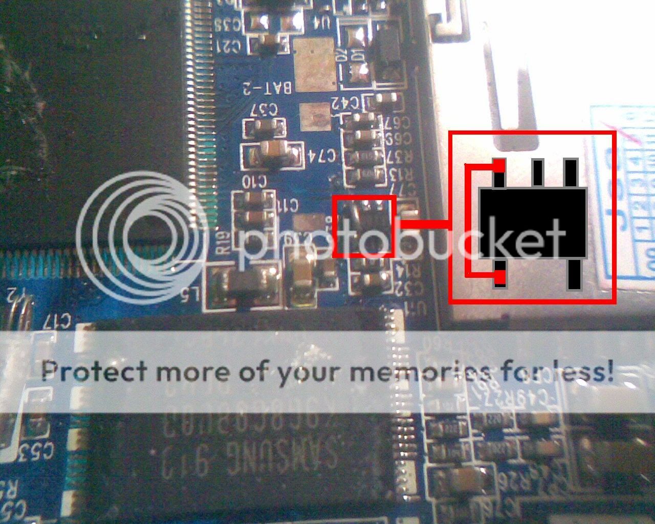

The green (power) led indacator is on when the power bottom press
But no display
when u release power bottom the green light is gone
so first check
boot the player with boot mode key
if computer not dectet your player
first change cyrstal oscillator (27.00 mhz)
not ok
change the RAM ( not flash memory)
