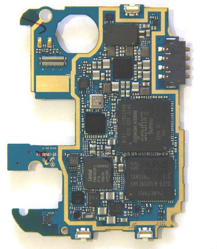

1. Here pcb. for example we take GT-I9500 board.

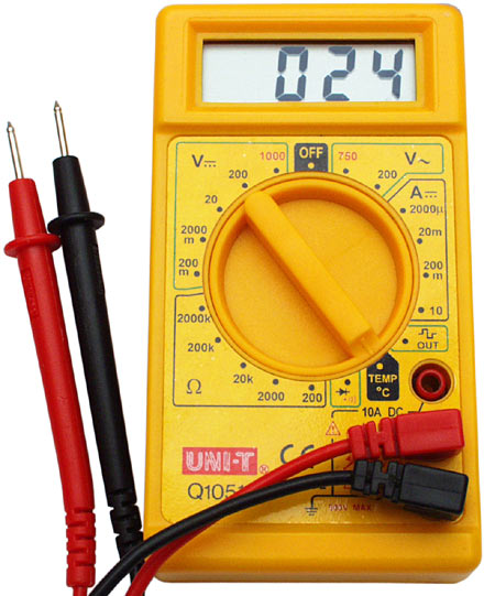

2. Multimeter.

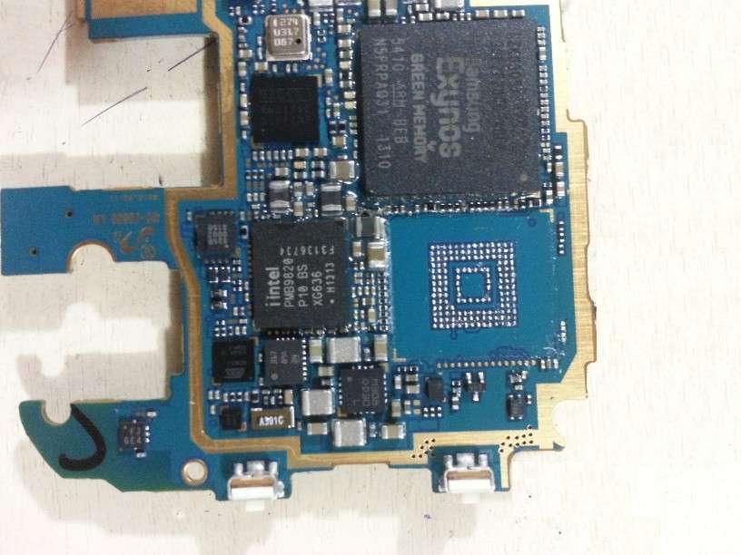

3. Here pcb with removed EMMC.

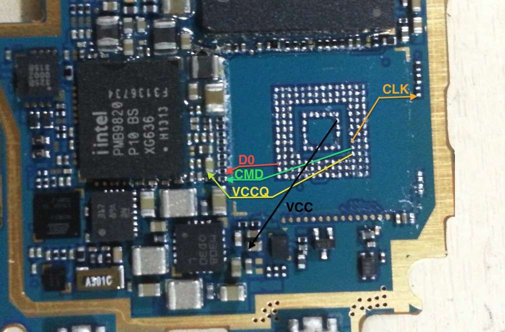

4. Here pcb with market pins. Check position point before start job.

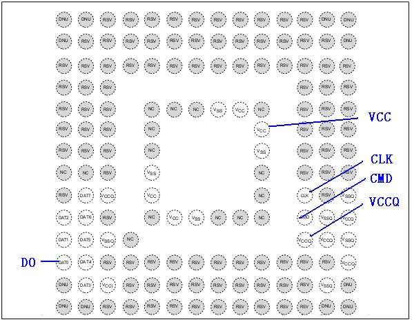

5. Here default pinout of BGA169 emmc with position point and pinout.
6. Now using tester need test where go pins.
LETS GO. Now you can connect to emmc.
