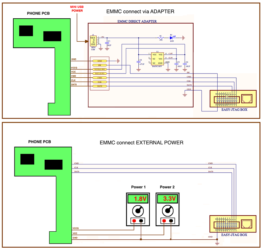

FAQ - DIRECT EMMC connect in pictures!! DONT ASK MORE!
HERE SAMPLE OF CONNECTION TO PCB.
===============FAQ==============================
Q - If i not have Adapter can i connect to EMMC direct on boart?
A - YES. But need use 2 external power.
Q - Why i need use double voltage?
A - VCC - power of NAND memory inside eMMC (can be 2.8 - 3.3V)
VCCQ - power of internal emmc controller. (can be 1.8 - 2.8V) (need setup vccq in sw same with real voltage)
Q - Do i need connect anything else to phone PCB ?
A - NO. NO NEED CONNECT BATTERY OR USB CABLE TO PCB.
NEED ONLY 6 WIRES: GND, CLK, CMD, DAT0, VCC, VCCQ

Q - Where i can take EMMC DIRECT connection pinout on BOARD?
A - Tested EMMC direct connect pinout we uploading to EMMC pinout under phone folder name on support.
Q - How can i find byself EMMC pinout.
A - Yes you can most of emmc have same pinouts. Need desolder EMMC and find where go 5 pins. CMD,CLK, DAT0, VCC,VCCQ
